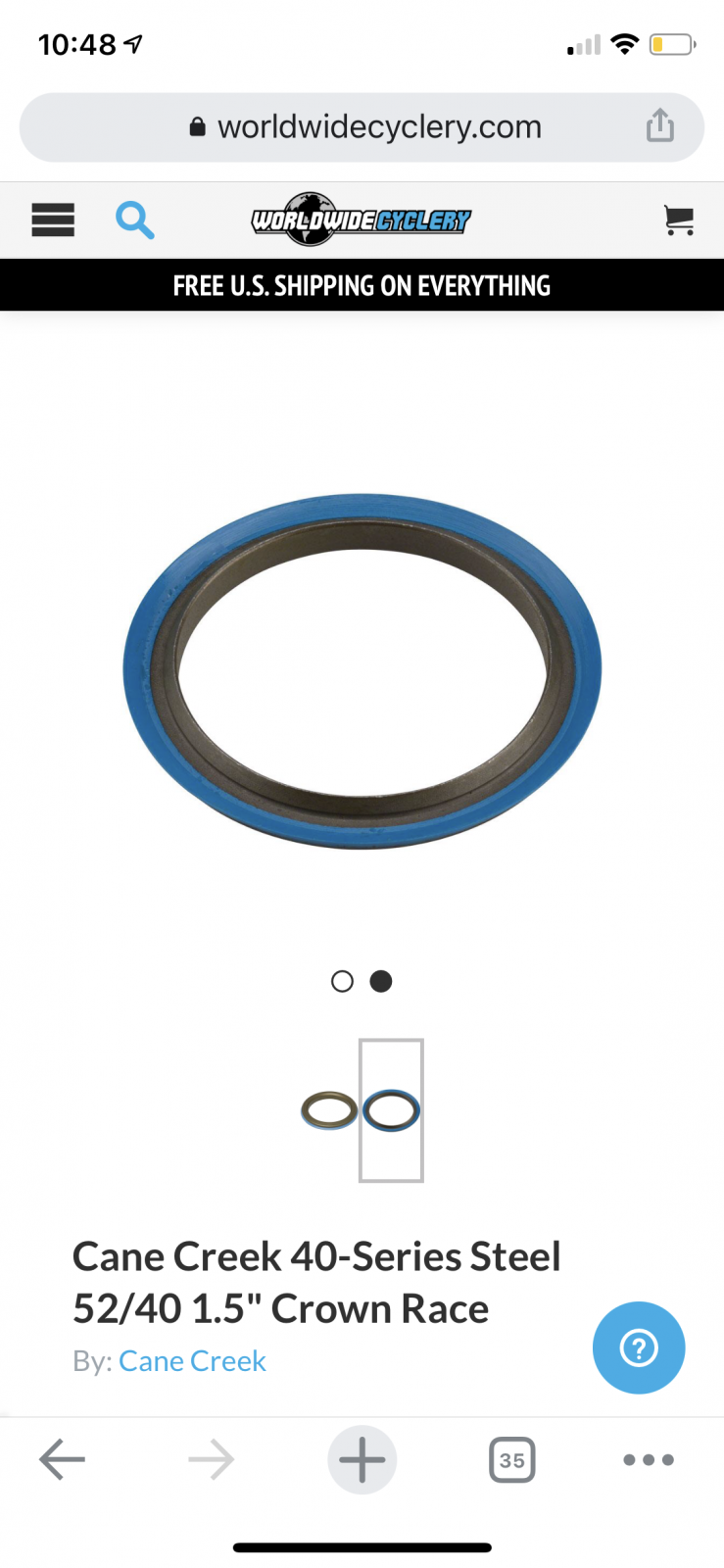

Hi Guys
I'm replacing the boxxers with a zeb and want to make sure I'm ordering the correct headset parts.
Currently the lower bearing sits directly on the boxxer crown raise.
Will I need to run different bearings?
Is this the correct bottom assembly?
Any help will be appreciated
Casey

If the original bearings/headset are still good, then why not just get the correct crown race for the zeb that's compatible with the current headset?
I purchased a cane creek 40 series crown race (52/40) 1.5" to fit a Fox 38
And if we are talking 2020+ Kenevos then there is no bottom assembly. It's integrated and only uses a bearing
This is what I've done. I was struggling to find the correct part but got it now :)
Cheers guys

Just to clarify, if I’m going from the Boxer Fork to a Fox 38, I can use the Cane Creek 40 series 52/40 1.5” crown race with the stock bearings?

Definitely, all the split crowns I’ve used have creaked and moaned. Also a few mates had the same issue.

It should also be noted that if you have the 2020+ Kenevo expert with the boxxer fork and you just want to replace the stock split crown to eliminate creaking you can use the stock lower bearing and buy a cane creek 40 steel 52/30 crown race to go back on the stock boxxer steerer tube.
Update as of 5/2023: Another forum member mentioned something about the angle of the lower bearing race being different “not standard” on stock specialized bikes so I’m not 100% certain now. If I can locate the member posting I will update the info here.

For anyone looking it seems like these options will fit:
