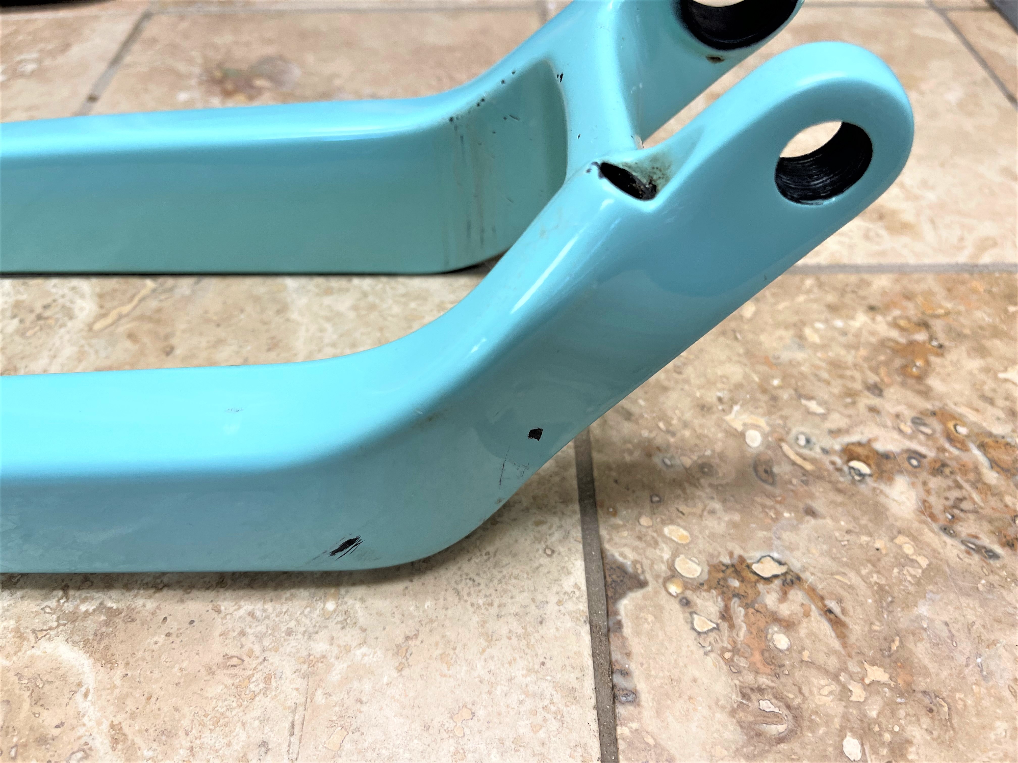

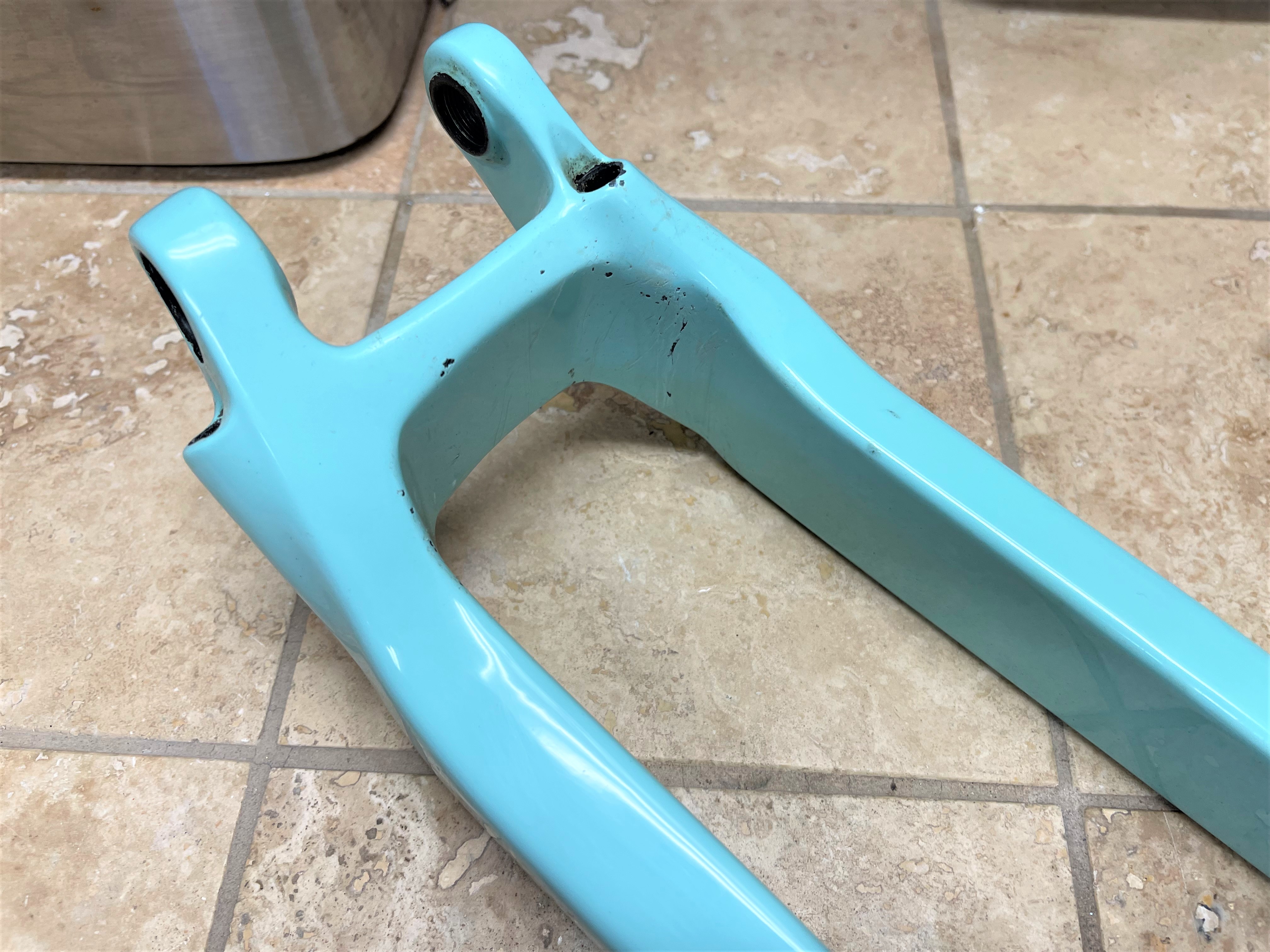

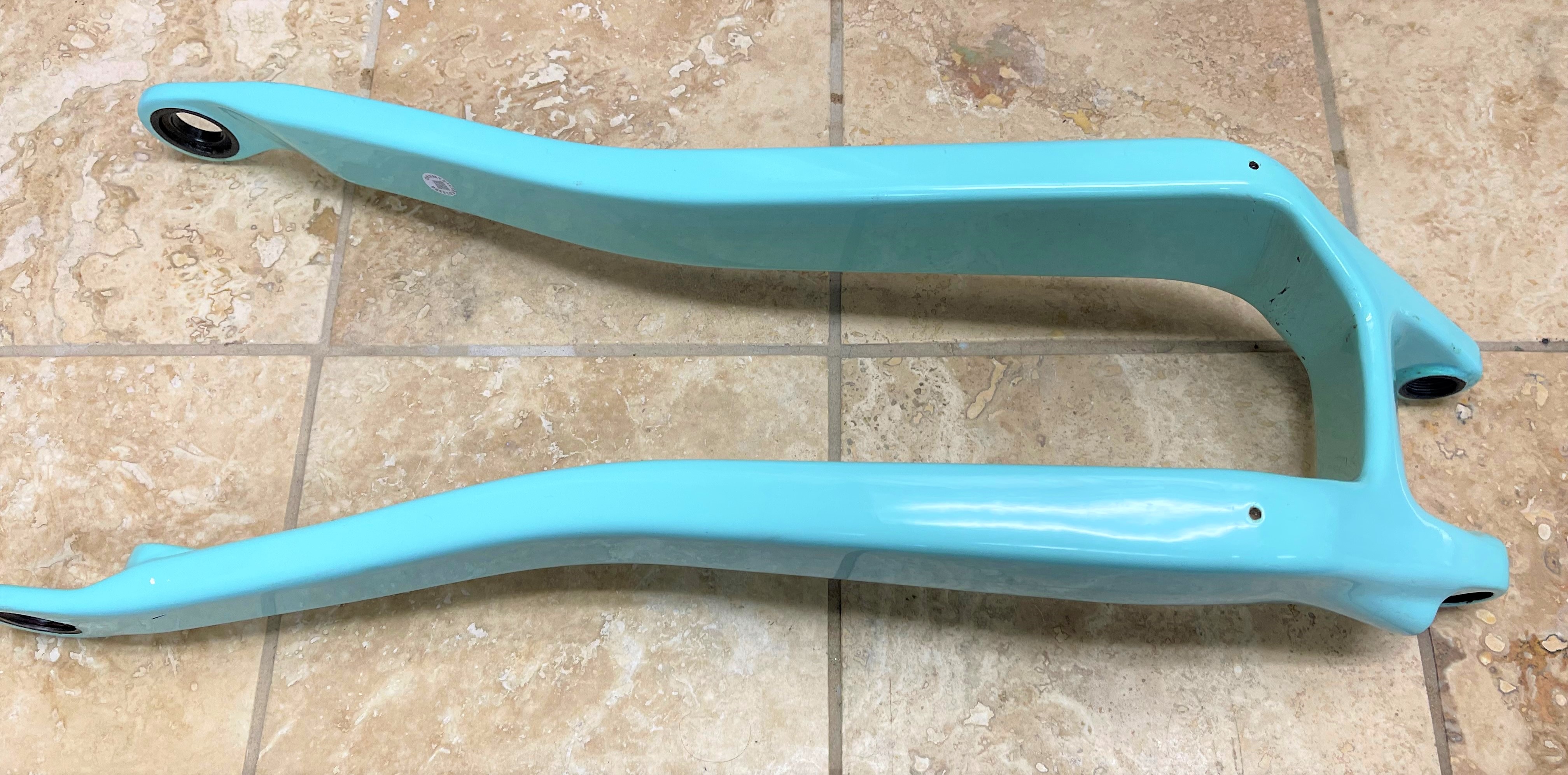

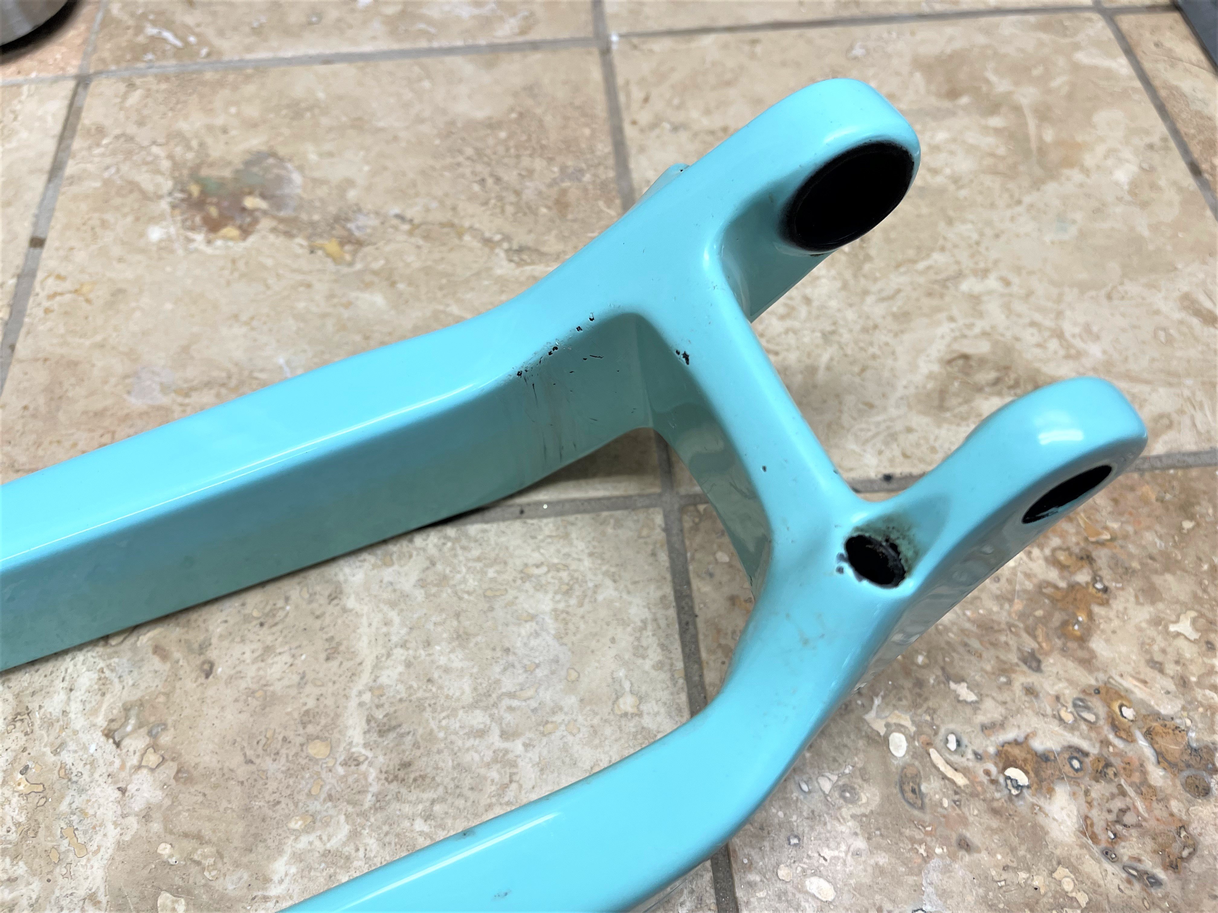

Several months after I got my Rise M20, the clear coat began peeling off the right "Seat Stay". I submitted the part for warranty and Orbea agreed to warranty the part as a paint defect. Orbea shipped me out a new "Chain Stay" instead of a seat stay. I offered to buy the chain stay as opposed to shipping it back to Spain. Orbea agreed to sell it to me for $125.
When I sold my Rise to my brother, I took the old chain stay off and installed the new chain stay on the bike.
The old chain stay is in perfect operating condition, however it does have a host of paint chips here and there around the stays. I am offering the chain stay for free to anybody who can use it. You will need to pay for the actual shipping, I can box it up.
Ideally, I'd like the chain stay to go to somebody who has gashed their chain stay and can really use it as opposed to somebody wanting it as a backup.
The paint chips can be easily fixed. The Orbea paint code for the "Ice Green" color is
Pantone color chart: ICE GREEN- P 571 C SOLID
For those interested, the dark green color is Pantone color chart: OCEAN- P 3165 C

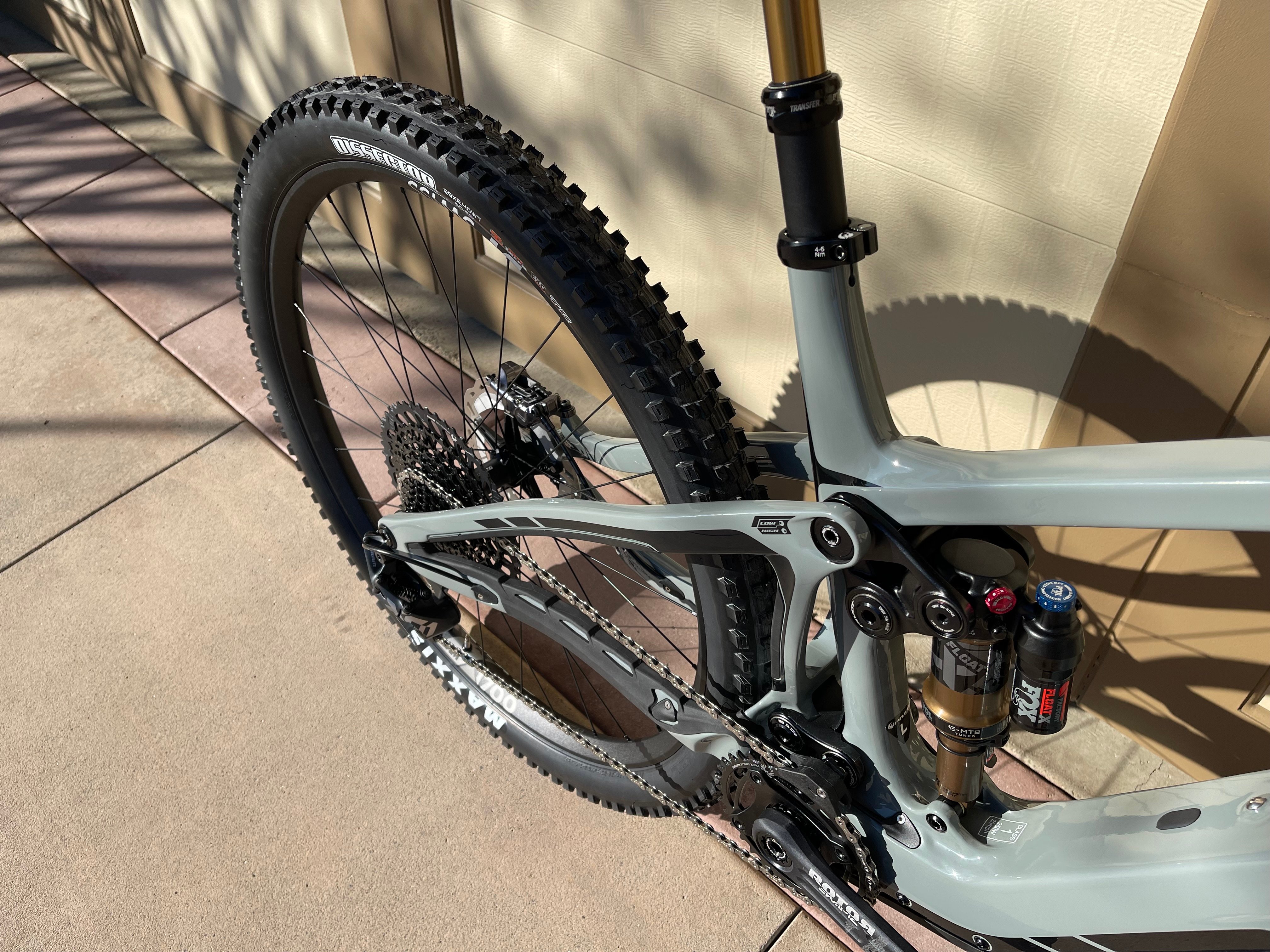

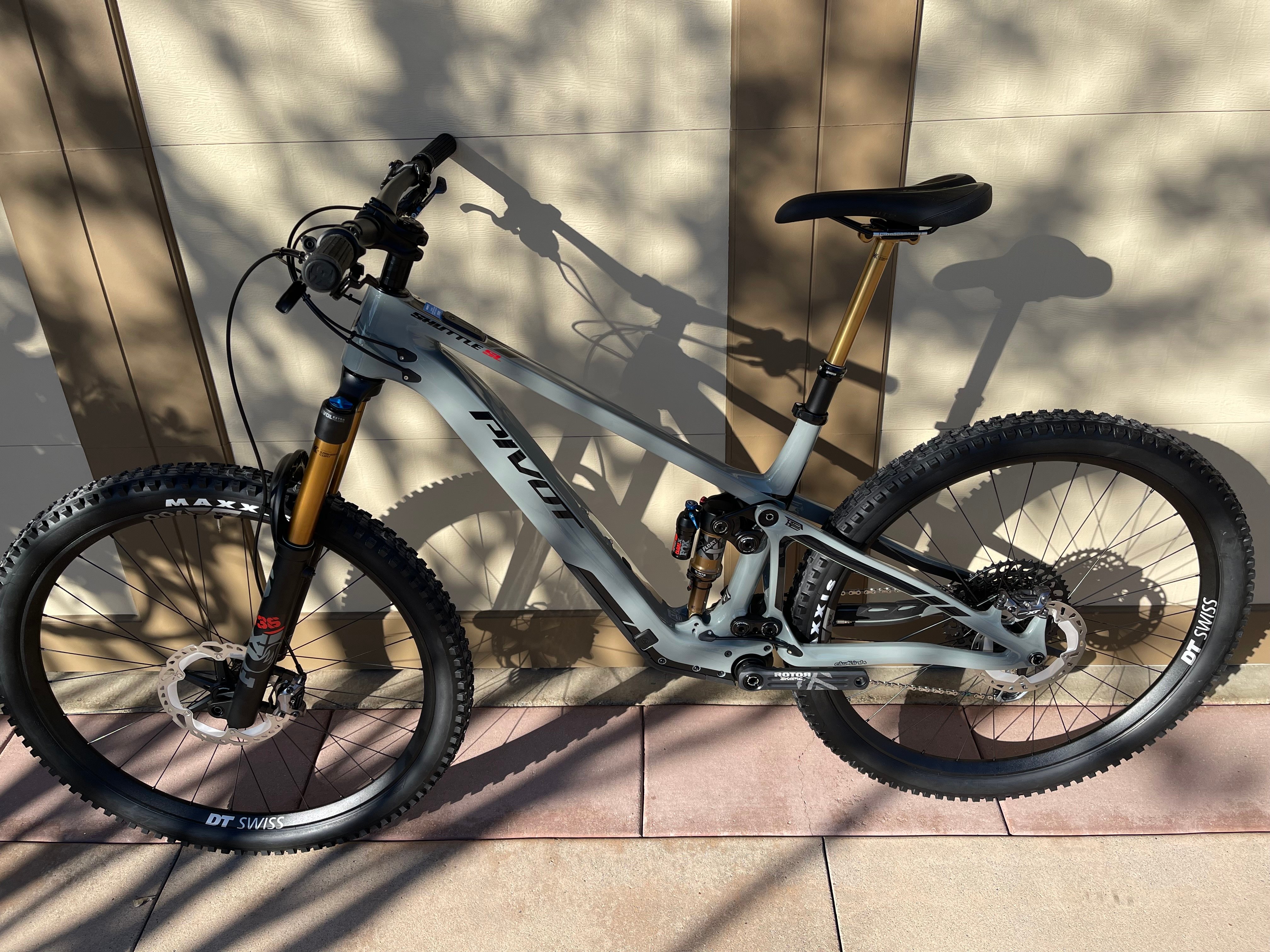

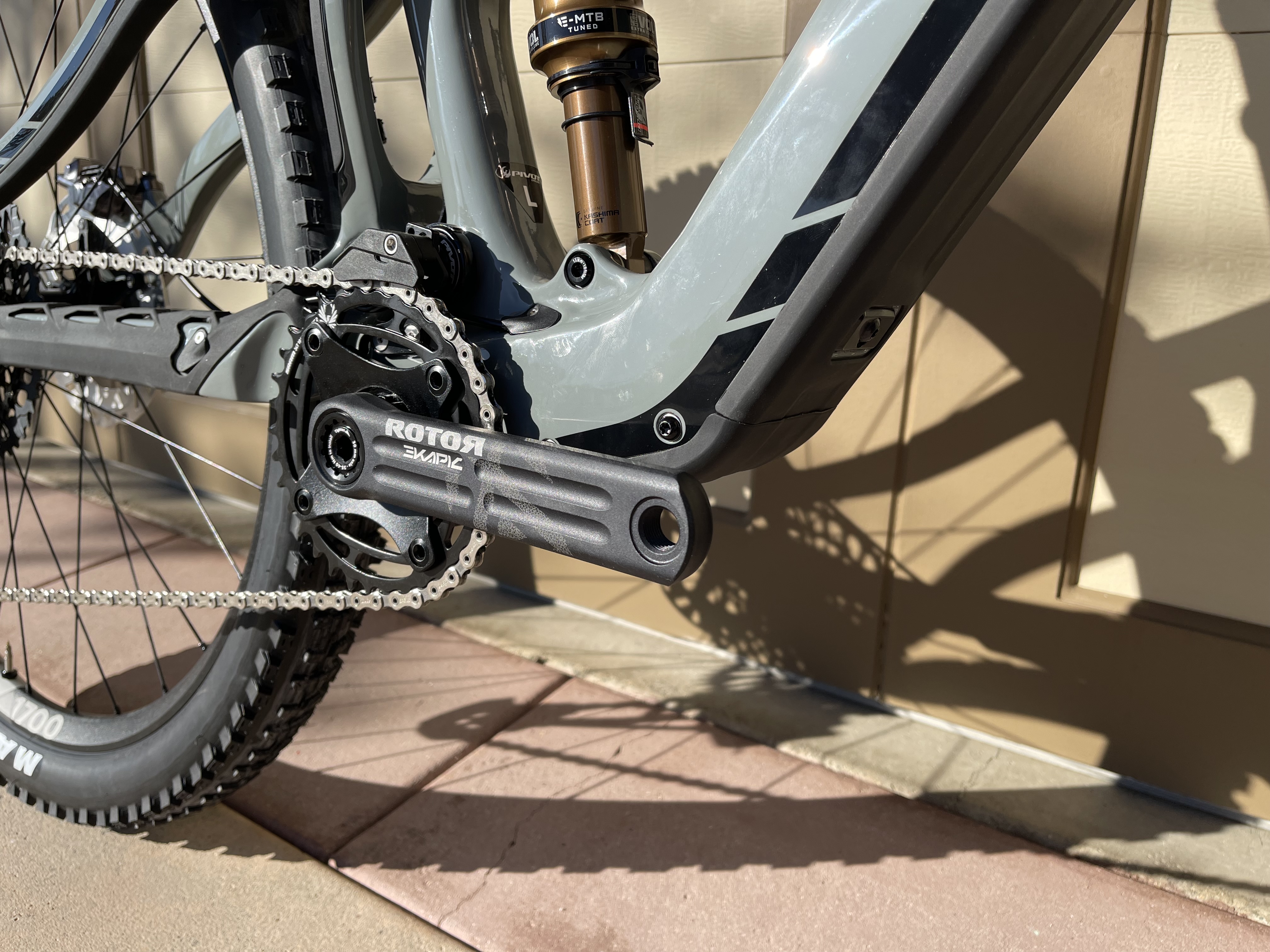

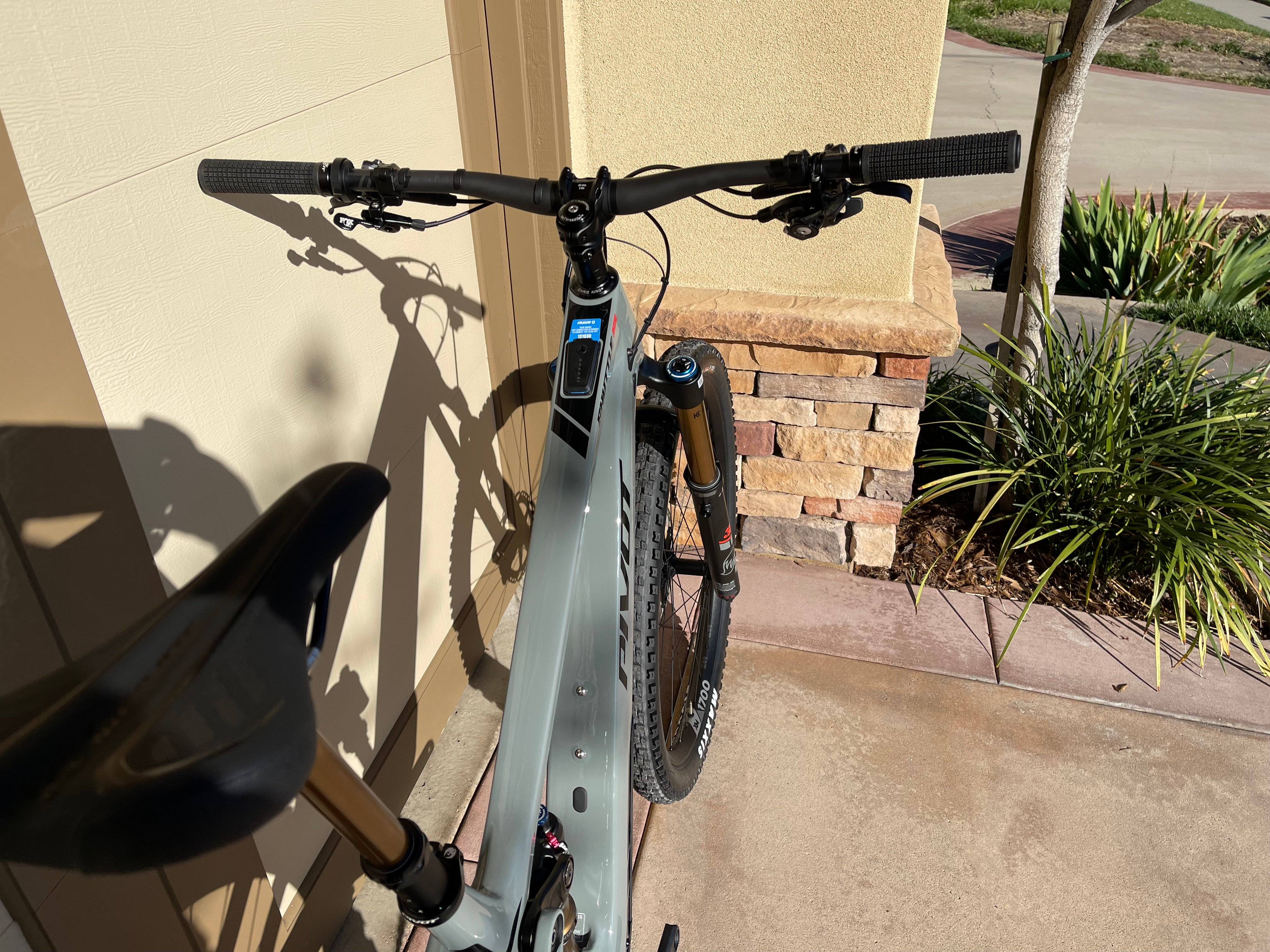

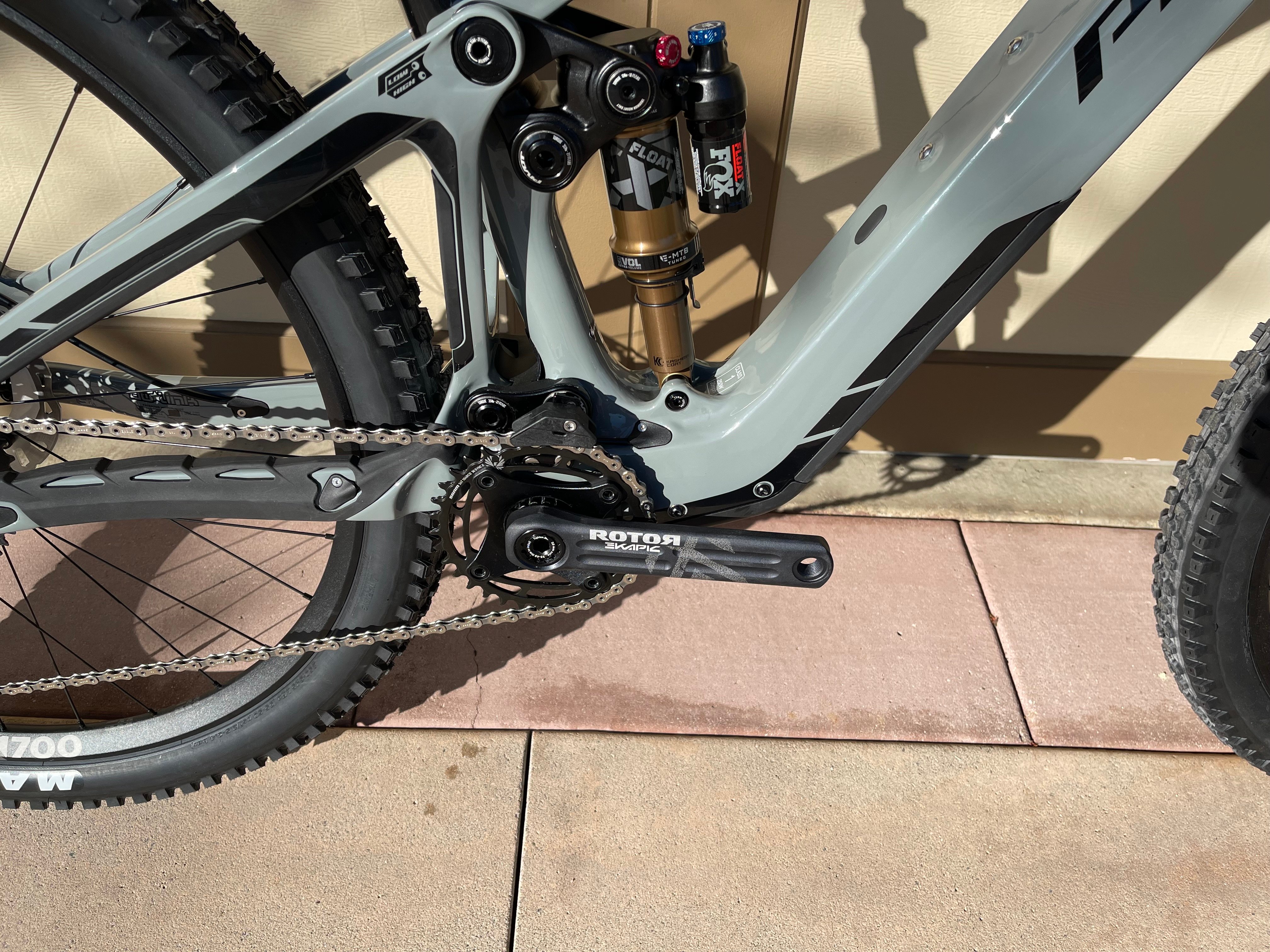

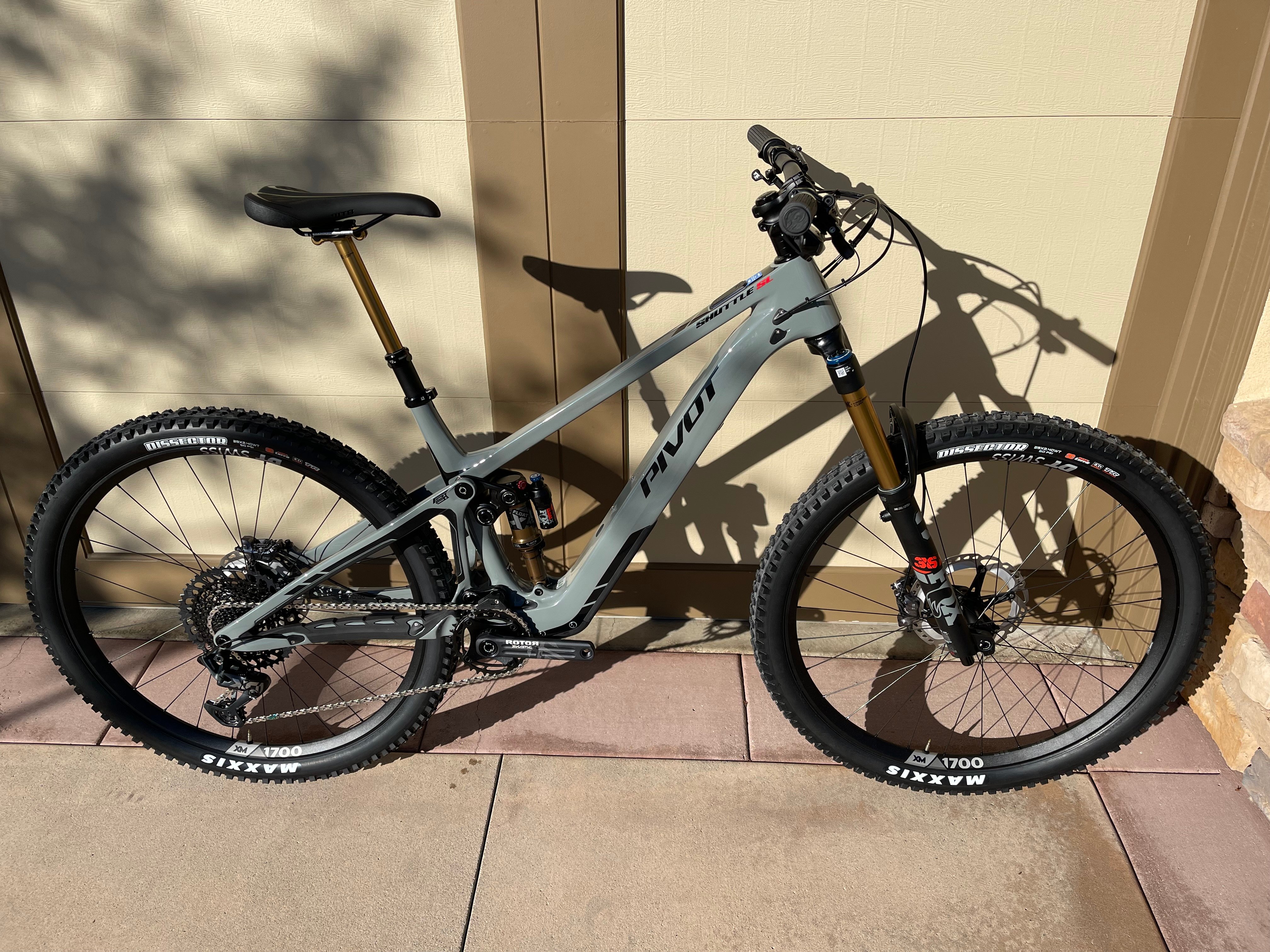

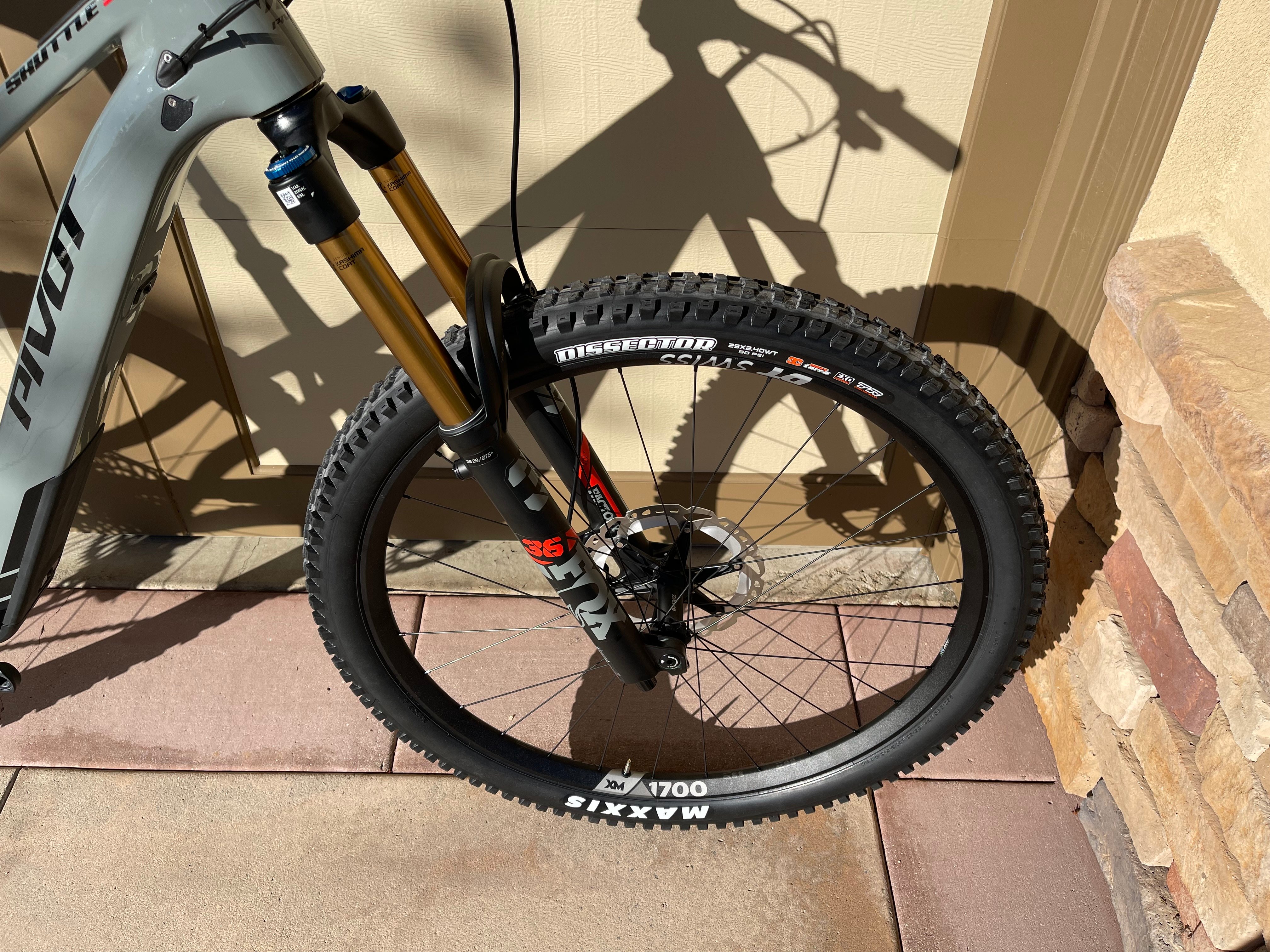

Here are some pictures of the bike.
