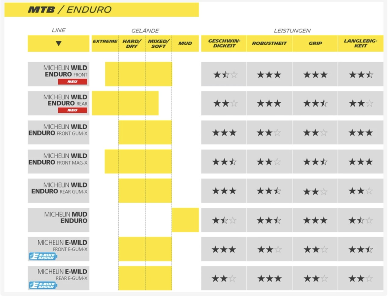

I bought a set of tyres for my Turbo Levo... Michelin E Wild front and thought I was purchasing the same tyre for rear but when I received them, I noticed that the rear was a Wild Enduro (teach me to order after a few beers)! It states that it is eBike ready, so I'm guessing it's fine to use, or should I order the E Wild for the rear?
Not very knowledgeable about tyres but used the Michelin E Wilds on my previous Haibike emtb and never had any issues, so thought I'd give them a go on the Levo. By look and feel, they are both identical, however, the Wild Enduro states that they are 3x33 TPI, whereas the E Wild is 3x60 TPI

The e-wild rear is a slightly heavier construction than the wild Enduro rear, the standard wild though is a great tyre so you should be fine. I've been running a pair on a Kenevo as I like 2.4 and the e-wild is wider. They roll and use a lot less battery than something like a DH22 - but obviously not as bullet proof or with the same ultimate level of grip. If you've got any worries about puncturing or rim damage, just run them a couple of PSI higher and you should find it supportive.

I have used the Wild Enduro on a Levo and they are fine in all conditions.............in fact I would rate the front tyre as the best I have used beating both Magic Mary and Maxxis Assegai.( my 2nd favourite tyre front or back). I avoided the E wild because for me they are too wide. I prefer 2.4 or 2.5 max because they squirm less and on the rear give greater mud clearance to the chainstays.

Just in case:

Thanks everyone. I was hoping I could use it as I can’t seem to get hold of an E Wild rear, everywhere out of stock and that goes for other brands I’ve searched for.
