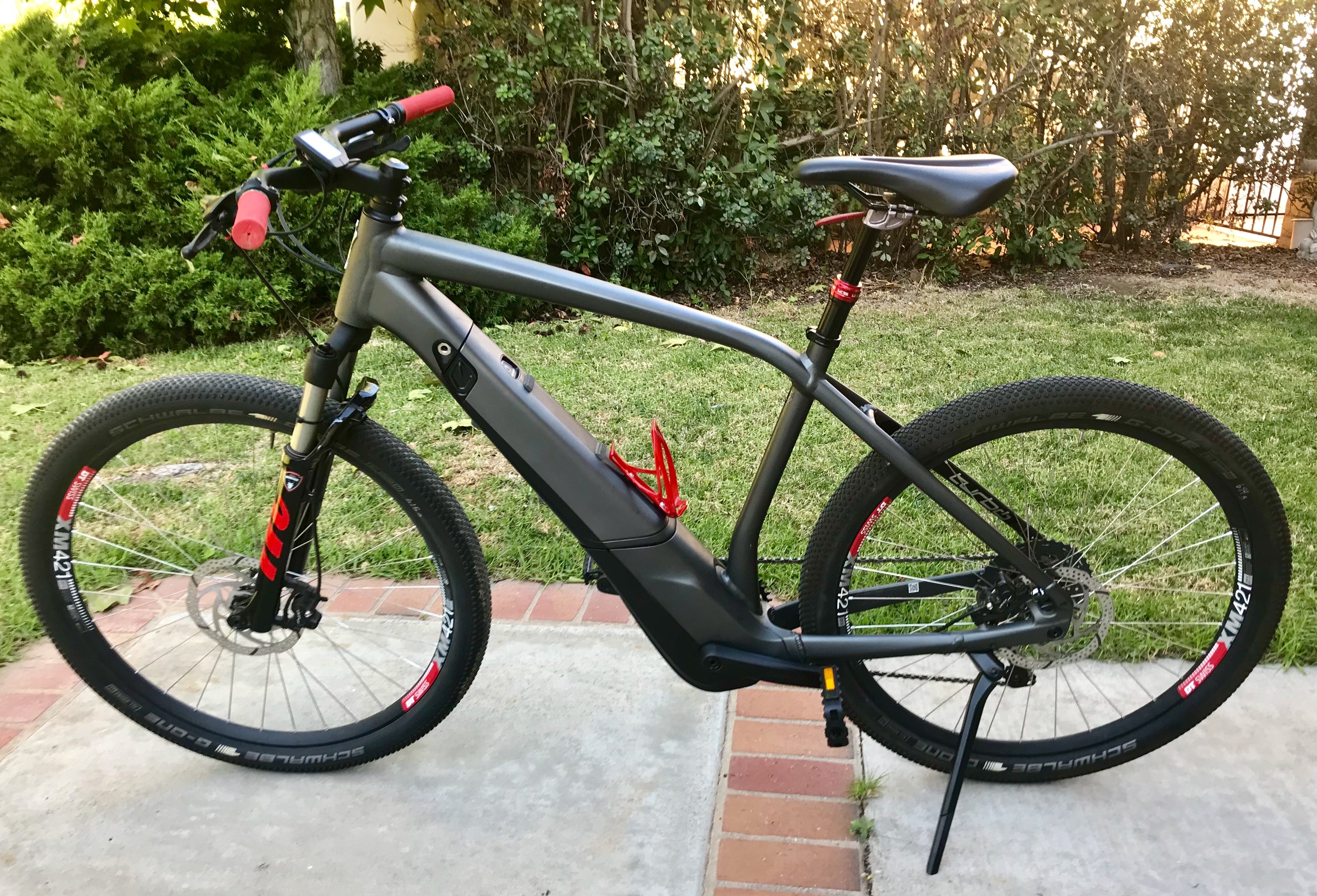

Check out Answer Pro Taper 20/20 bars
here they are on an older Vado

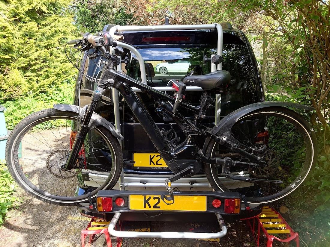

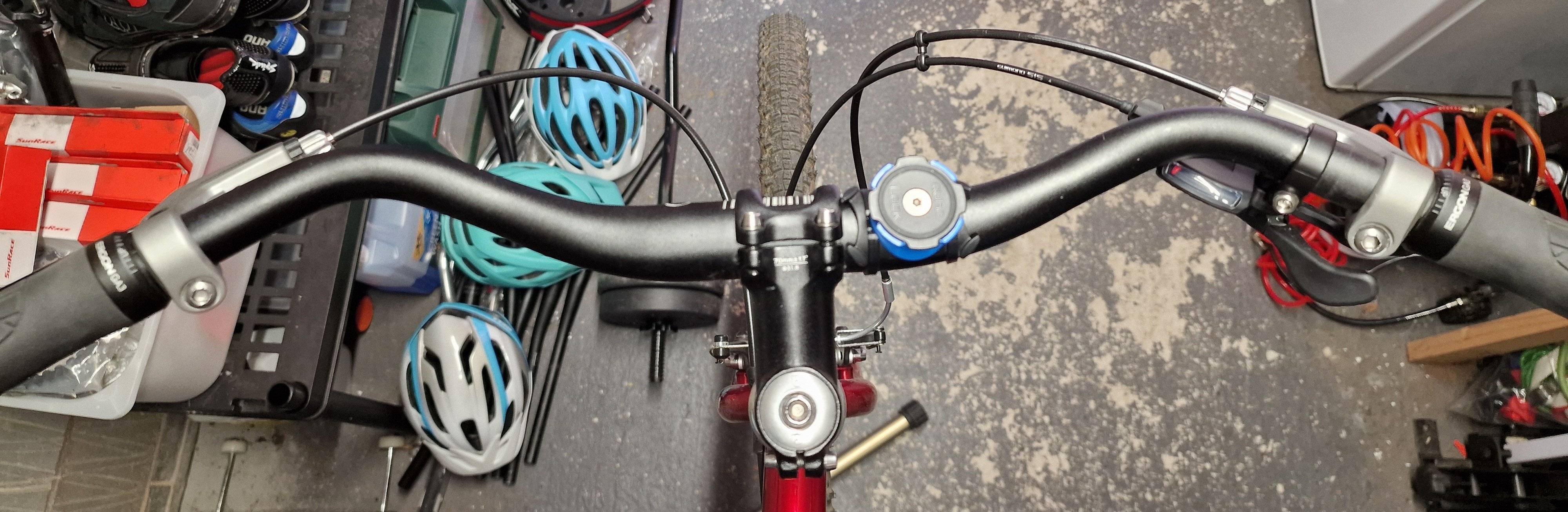

On-One OG V2 Handlebar
Tried the On-One Mary Bars but they were a bit too swept back for me.
The OG V2 are better.
I also have an adjustable stem for an even more relaxed time :)
On my Fiamma Low Loader Mod - You can sort of see the bars ?!

Here are the OG V2 on one of my old bikes
Thanks for your reply and the image, gives me a good idea on what to expect.
So far I've had my eye(s) on the Ritchey Comp Buzzard Handlebar, with a rise of 70mm flat rise
and back sweep of 27.5. However, I may buy 2 handlebars as I have 2 mountain e-bikes, so may go for the On-One OG V2
also.
