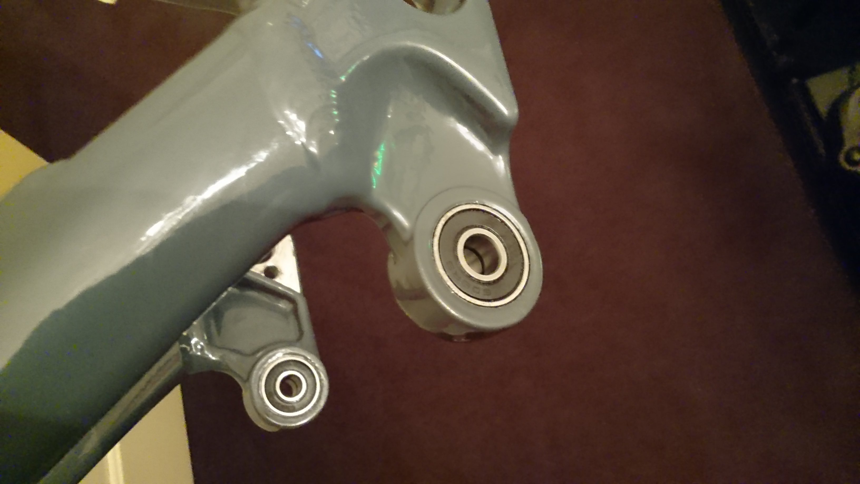

2 years on and a tad over 5200ks the bearings are shot, we'll they were junk to begin with, anyhow I've replaced them all apart from the double bearing that sits on the end of the chainstay, these bearings are 63801, they sit back to back, so you can't press them out as I have every tool for the job, and a blind bearing puller hasn't worked either, does anyone or has someone managed to get these out, if so how please..
Thanks in advance

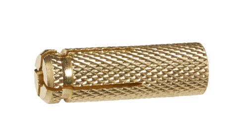

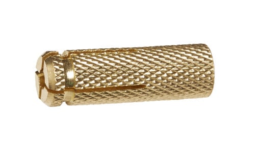

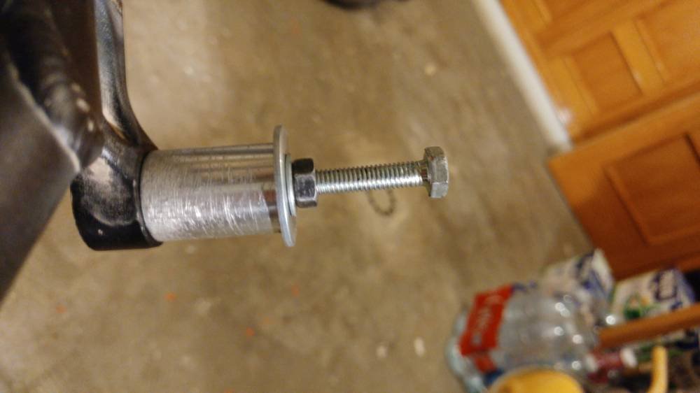

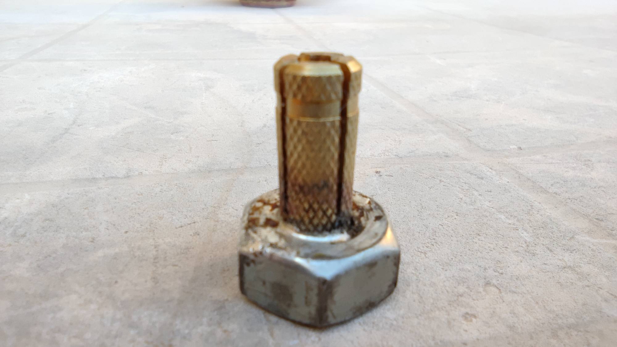

Some time ago I was able to remove the 688 drop-out bearings (8mm inner race) in my 2006 Stumpjumper, and in some days I will remove the ones in my Ghost ebike and I am posting below the process I am following.
The 688 drop-out bearings will need to be pulled out from each side of the frame’s forged drop-out with a 8mm sleeve anchor:
* Push the 8mm sleeve anchor into the 688's 8mm inner race.
* Place a tube or socket, which is slightly larger than the outer diameter of the 688 shell.
* Screw a 6mm bolt, flat washer and nut into the sleeve anchor.
* Tighten the bolt while holding the sleeve anchor with pliers so the inner race is not allowed to rotate. The sleeve anchor will wedge into the inner race of the bearing so it can be extracted.
* UPDATE 20230420: The biggest issue with this method is to screw the bolt that opens the anchor and tightens it inside the bearing inner race. The inner race rotates so to tighten the bolt you have to grip the anchor with a plier, but it is quite difficult to grip it. So I just soldered a 10mm NUT to the Sleeve anchor, I used a torch and strong tin solder with 6% Silver, which is used to solder copper pipes. Now I can easily grip it with a hex wrench. See pictures below
* Now tighten the nut slowly against the washer and it will pull the sleeve anchor with the bearing attached to it.
* For the opposite bearing you can repeate this process or push it out from "inside" because now there is no other bearing.
Taco Laton 2.jpg Taco Laton 1.jpg Rodamiento 5.jpg Sleeve Anchor w Nut 1.jpg Sleeve Anchor w Nut 2.jpg

I tried also the Dyna bolt and it didn't work for me either. But the "Brass Anchor Sleeve" worked well.

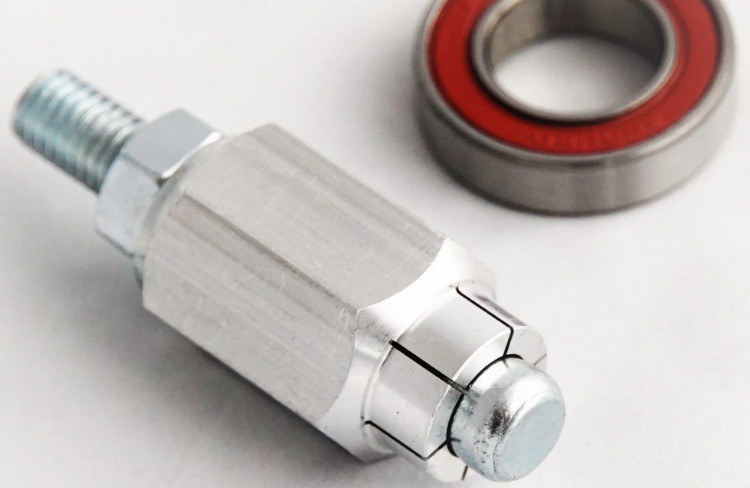

I know about the BearingProTool, although the pictures in their web are not of the 8mm 688 one, but a larger one, and I fear that the 688 one will have a 1mm wall between a 6mm bolt and a 8mm inner race, and this may be too thin to be robust.
Please, post pictures of it and tell us if it looks robust or it looks "single use".
That's what I've ordered eta Friday, giddy up hopefully 😁
View attachment 111678 View attachment 111679 View attachment 111680
Yep
Seen this method used and work
Also I see a yt vid of someone using a drift getting a perchase on the inner side faces of the bearings looked a right have but it worked
* UPDATE 20230420: The biggest issue with this method is to screw the bolt that opens the anchor and tightens it inside the bearing inner race. The inner race rotates so to tighten the bolt you have to grip the anchor with a plier, but it is quite difficult to grip it. So I just soldered a 10mm NUT to the Sleeve anchor and now I can easily grip it with a hex wrench. See pictures below
View attachment 111678 View attachment 111679 View attachment 111680 View attachment 112146 View attachment 112147

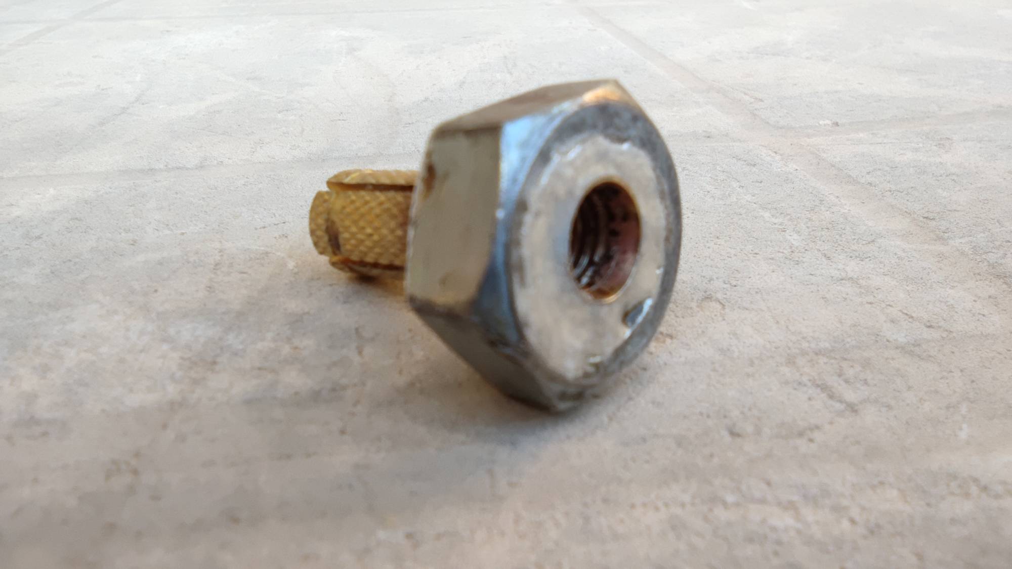

UPDATE: The biggest issue with this method is to screw the bolt that opens the anchor and tightens it inside the bearing inner race. The inner race rotates so to tighten the bolt you have to grip the anchor with a plier, but it is quite difficult to grip it. So I just soldered a 10mm NUT to the Sleeve anchor, I used a torch and strong tin solder with 6% Silver, which is used to solder copper pipes.
Now I can easily grip it with a hex wrench. I still have to try it and replace the dropout bearings in my bike, but it looks promising.
